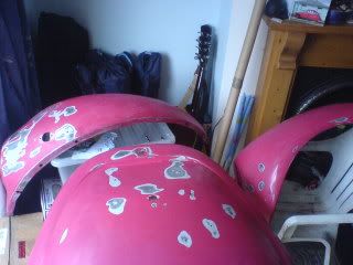

So, I've got the old bent crashed into wing to practice on, and am in the middle of prepping it the best I can. It's quite good as it has rust and dents on it, so I can practice using filler, kurust, and rubbing down before I attack the main thing.
Here is a photo!

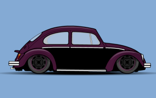

So, the colour scheme I have decided on is very dark purple all over, including the wings, with cream doors and side panels, in a two-tone style. Also, I'm thinking black bumpers and black wheels now as well
Here is a link to the colour which I shall be ordering tomorrow.

Well, I've ordered the paint and have decided on one of the following schemes, depending on the exact shade the purple comes out at when it arrives. As the interior is cream I am leaning towards the white one.
I've got a fair bit of prep to do on the front wings and the bonnet, but rather than taking it apart now I'll wait until the paint turns up and practice on the wing first - I'll get pics of the first coat up hopefully at the end of this week.

Well, there's a slight delay on the paint so i have starting taking the car apart. I've prepped the front wings and just started on the rear decklid today, tomorrow I'll get the front bonnet off and perhaps the rear wings.
Paint ETA is this Friday so hopefully after the weekend I'll be able to put up some pics of the first coat on all these bits. Sanding down is very boring - I don;t recommend Wilko's wet and dry because although it's cheap, it runs out of after about half a wing, so I might get some decent stuff online.
It's quite satisfying getting that rust off though...
