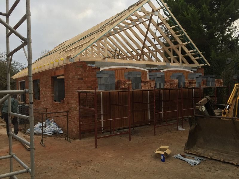

That is some garage Slugster
Did you crane those trusses in they look monsters?
76
Thank you
Nah, no cranes.
And no Hiabs either DS
I made a dolly with two barrow wheels and a bit of bar so I could roll them into position and leaned against the front wall.
Then walked the ceiling chord onto the digger forks, and as the front loader was raised to plate height the ridge was slid along a scaffold running up the centre of the garage.
We stacked them from back to front so they could be stood up in order and braced.
The process took 3 blokes 7 hours.
I was happy with that.

What width were they? I have some 13.2m ones coming a week on Monday.
Yikes those are big buggers.
Mine were only 8m
I imagine you will need a big arsed crane for those.
Mine were only 8m
The plan is a crane, we've got good access but only from one end as the job is 'tented' - hoping we can sit them on then slide them along the wall plates maybe with a couple of ropes tied into the ridge position to help. It truly will be a suck it and see type job
