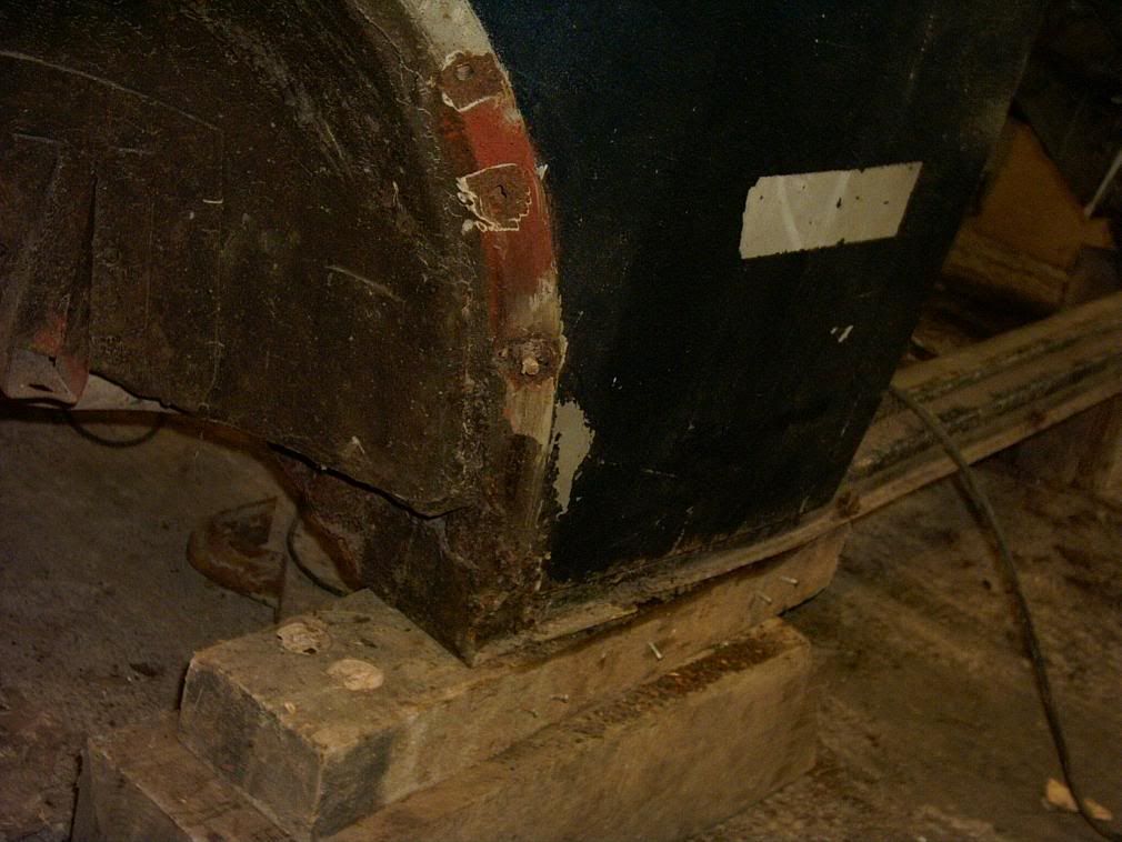

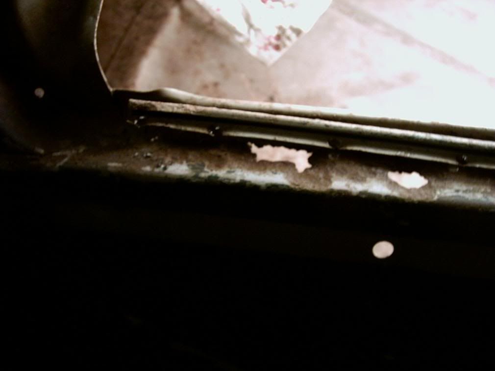

I took a few photos of the worst bits when I got it home
bonnet edge
rear arches
some qwality repairs there

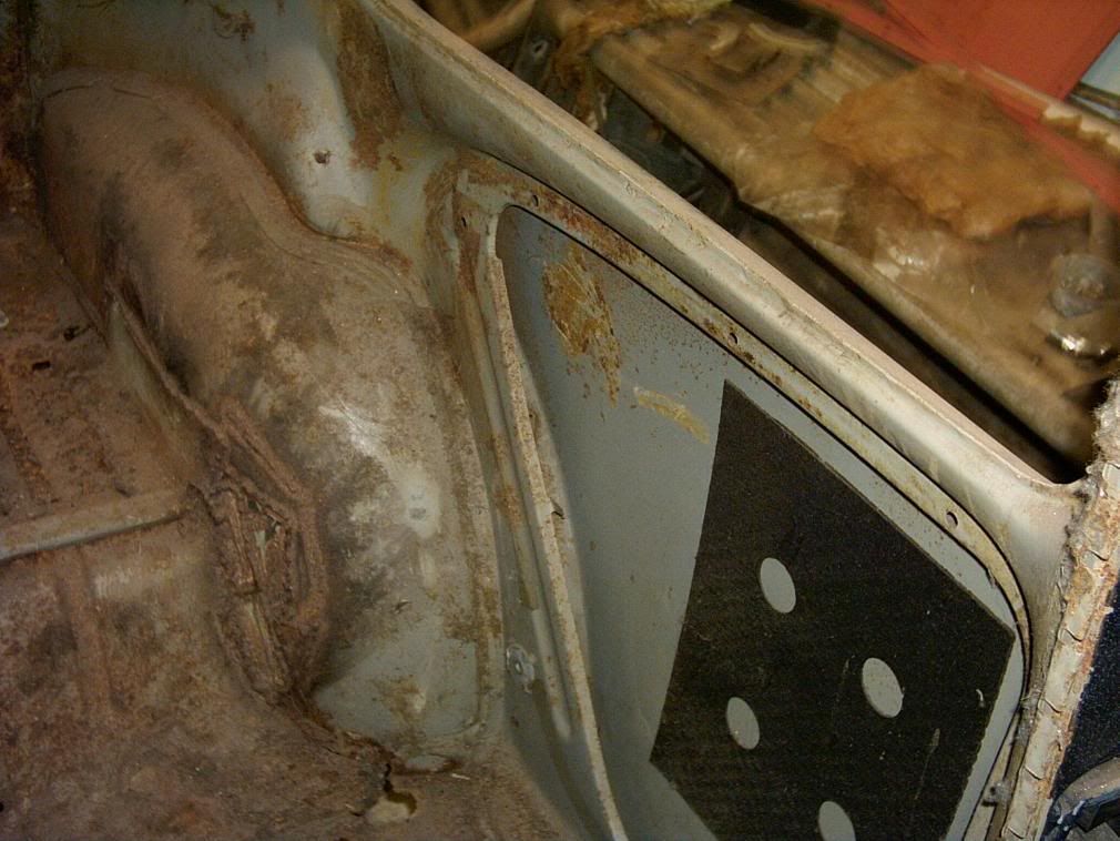

first summer I attacked the floorpan, started by cutting off the jacking points and repairing these areas. retrospectivly, I perhaps should have bought complete new pans, but its done now, they should be ok for a fair while.
some photos;

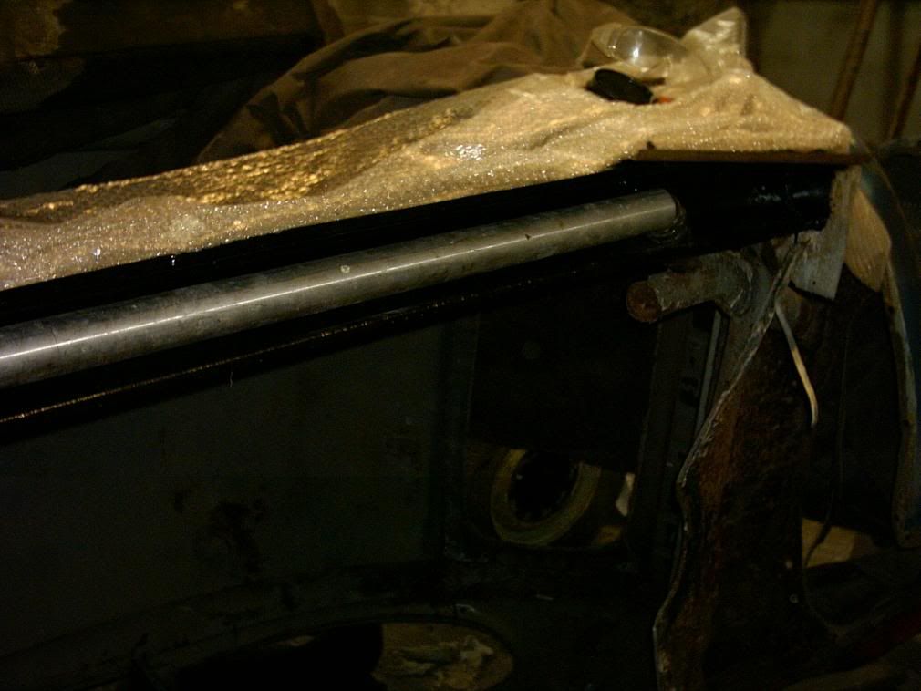

I should say, before I did this, I made a pan roller, I thought I'd took photos of it but cant find any.
then set about sandblasting the pan, front beam and various other bits; drums, backing plates, pedals e.t.c in my newly constructed hell - a large trailer with plastic sheeting over the roof and me, a hobby sandblasting gun and a lot of dust and rust. spent the best part of 2 weeks in there. I'm not doing that again.

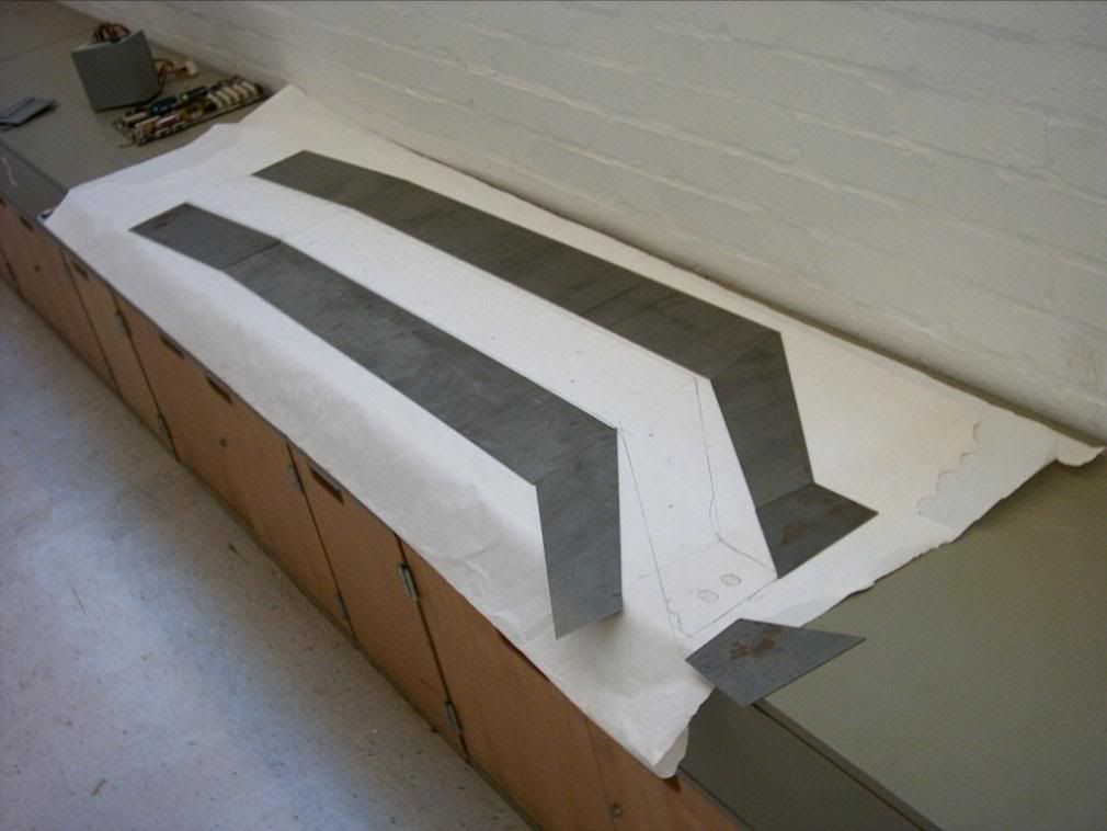

originally, I thought I'd get away with just replacing the bottom plates, but further investigation revealed, the heater tubes and channel outer edges were poor.
so I made some more!
bottom plates:
2mm should do the trick, SS nuts welded on.
heater tubes:
stainless steel, 50mm, tube. those double bends at the back are a bit tricky to make.
all por'd and welded up
I have since, seam welded the entire outside and inside for those of you worried there aren't enough spot welds there.
