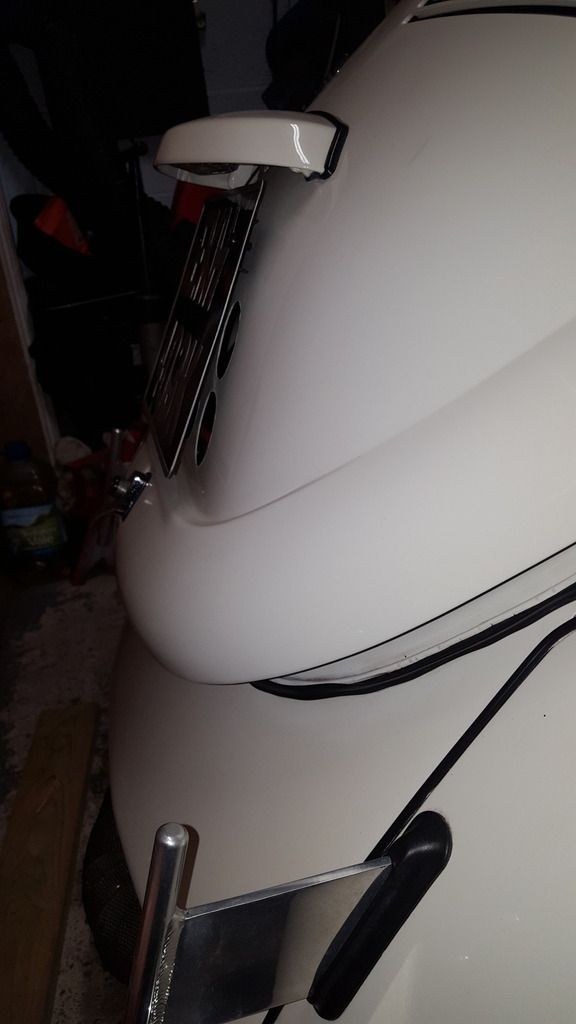

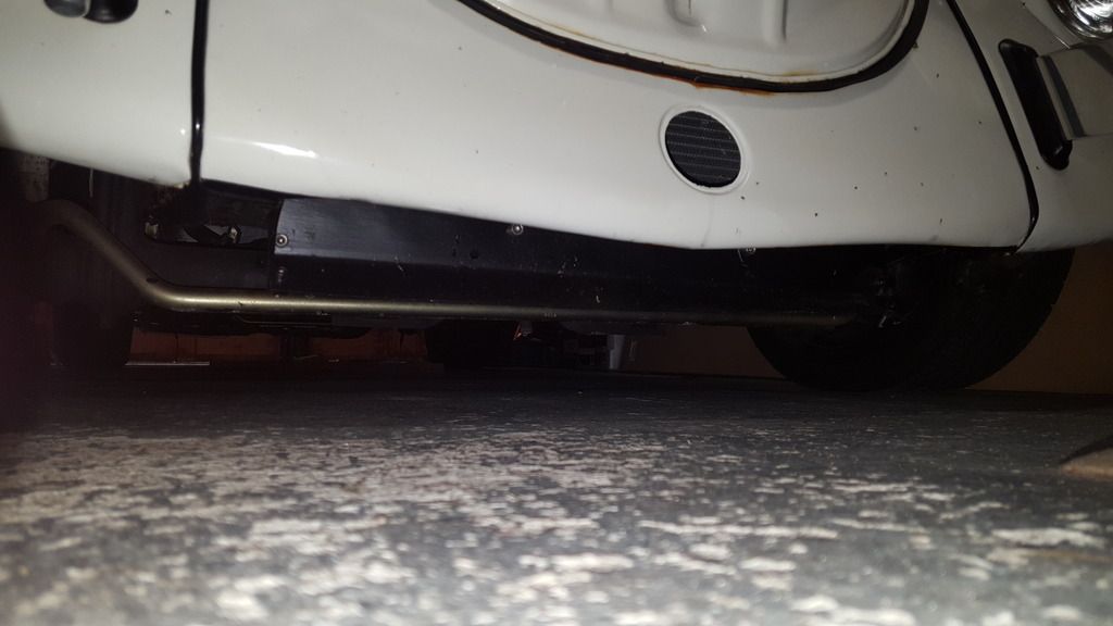

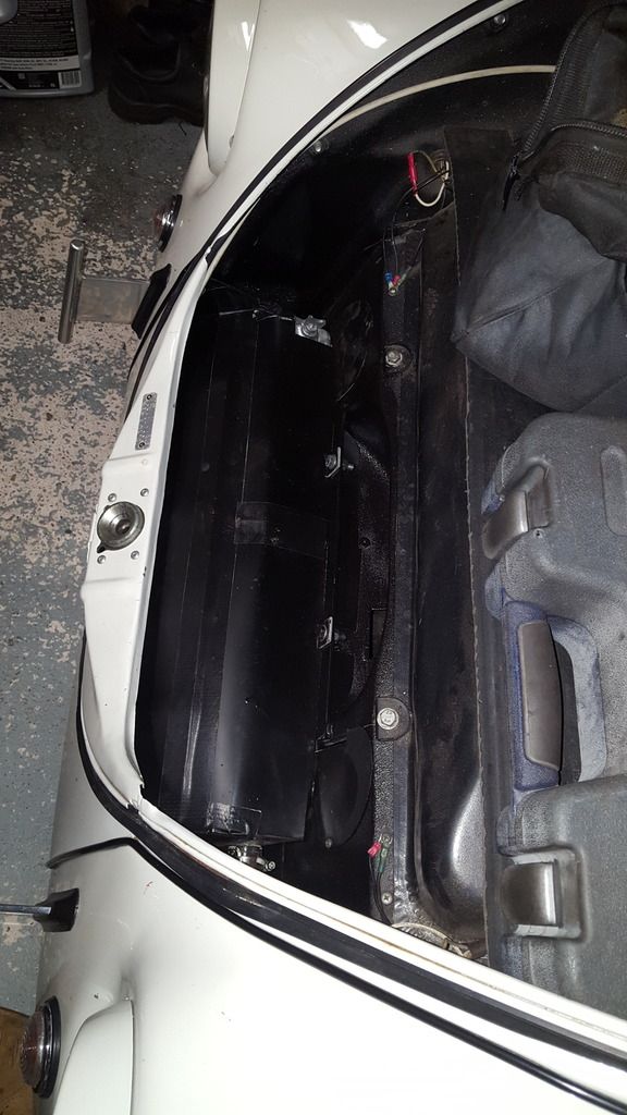

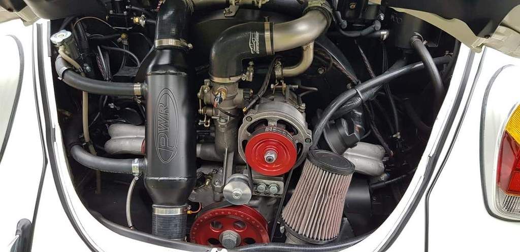

Hi cliff. I run a 2017cc EFI with a T3 11psi boost at present and a chargecooler ( radiator up front in spare wheel well ) in my bug. The radiator is 23" by 6" by 2" and I use an additive to help heat transfer, i have put a scoop to push air through the radiator. I also run two external oil cooler radiators with fans.
On a hot day on the M1 cruising at 70 - 80 mph and the odd run 100mph+ my max oil temp was 95c ( sender in deep sump ) , I never had to put the fans on, my intake was max 20c above ambient. I prop the bottom of the engine lid open about two inches and I have punched 6 large holes behind the rear number plate to get cool air into the engine bay.

My bug isn't an 1303 but you can mount the radiator similar, some 1303 had a vented front panel for aircon. So you could cut some nice factory looking vents there ?
My chargecooler pump is mounted on the frame horn, it has to be low in the system and on the return/cool side to the chargecooler. Also the cool water goes into the chargecooler at the throttle body end. The bigger the coolant capacity the better, mine is about 5 litres in total, the chargecooler barrel should always be cool to the touch.
