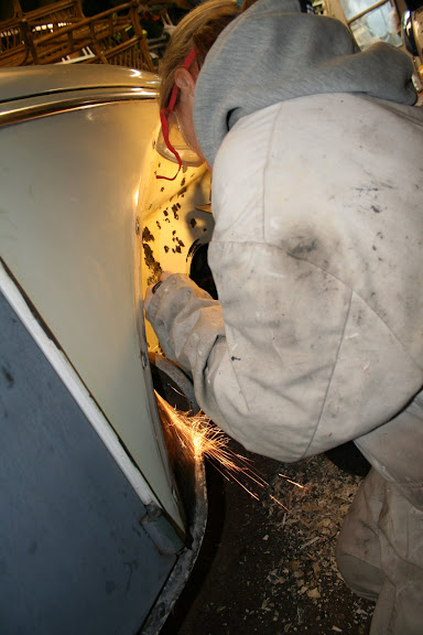

My trusty helper then proceeded to de-crud and clean the inner wings....

lol, she looks like a nutty professor or something.

Location: Somerset/Devon
Posts: 796
All the spots of surface rust from stones being thrown up and water being held in the crud had to go so before I knew it ..............
Just as well, cos I couldn't be trusted with a grinder. After cleaning up the rust before welding, idiot brain (me) momentarily took his goggles off for a better look and got 5 metal shards in his eyes. After a sleepless night and severely aching eyes, I had a go at getting them out but no joy so off I trotted to the chemist for some optrex. The lady in the chemist ordered me to the doctors so off I sheepishly went. He told me I was silly which I already knew then sent me off to casualty for a few hours. Eventually after some blokey poked me in the eye for 30minutes, I was sent home (not before the nurse had made me lie down for a bit as I was now as white as a sheet and about to faint (arghhh...I really don't like hospitals!) Anyway, suffice to say, lesson learnt.
kafer-k is offline   Reply With Quote
Yeah she's going to kill me when she sees I've put that one up!! eek!
They're my dad's safety specs from about 30 years ago, lol. I obviously wasn't going to put up the one of me wearing them
