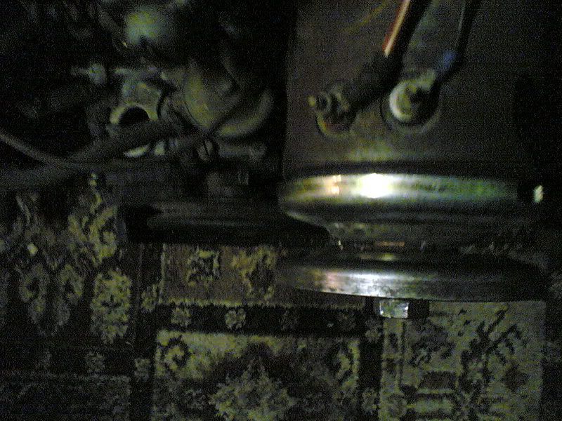

hi i'm attempting to convert my 1500 1964 split bus to 12v so i bought a 12v generator stand, generator (with fan, pulley & backing plate attached) fitted to original tinware but the generator pulley now sticks out about 15mm further than the old one did see picture below any idear's anyone do i need a different back plate or different tinware or something? thanks in advance

are they not all the same then? if not what do i need one from?
The 12 volt dynamo's are 12mm longer than the 6 volt. The difference is the backing plates. The 6 volt ones were domed, whereas the 12 volt ones flatter. There could be other issues, but suspect the plate is the problem. Peter Good www.volksgoods.co.uk
Peter Good said:
The 12 volt dynamo's are 12mm longer than the 6 volt. The difference is the backing plates.....
The 12v dynamos are 105mm in diameter and fit to same cover plates as 105mm 6v units. The exception to this is the 69-73 Type 2 12v generators which were longer than the Type 1 12v units, and were fitted with different cover plates to bring it back into line. My question is: where did this generator come from and was it pulled from a vehicle complete? It sounds like it is the long Type 2 generator mis-matched to cover plates for the short version.
do i need ... different tinware
Definitely. That Afghan pattern stuff in the picture just won't do :crazy: :crazy:
