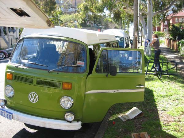

Hey all
My brother has been living in Aus for the past 2 years (lucky bugger) and has recently helped me import a stock 1977 2.0L aussie kombi, problem is he has challenged me to a race at Santa-pod next year with our bus's his is a 1972 1600cc running twin carbs and performance pipe's.
Big question who will win?
also wondering what bhp people are getting from there 2000cc type 4 engines an whats the best things I can to to improve my 1/4 mile times.
Thanks for any help
mark

they both have camper interior's but the 2.0L will be a little heavier.
is it worth me betting him a bit of cash then ;)
mark
