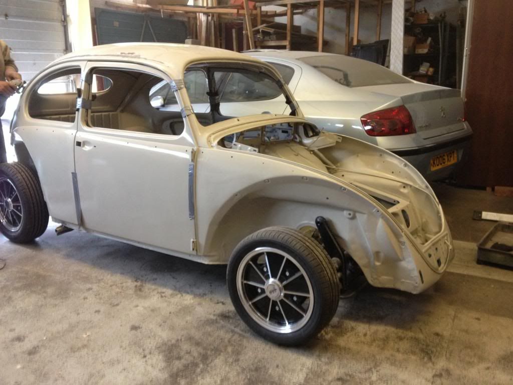

The roof was joined and welded on the swage line and understandably was too hard to keep straight that way. Even with filler on it was all over the place and could be spotted a mile off. For some reason a section was cut out with the drip rail on both sides and welded back in wonky.
You can see how its buckled in the picture.
There is quite a valley where the roofs were joined. You can see the dip between the car and the background.
Got it looking better with a hammer and dolly, it will do for now.
