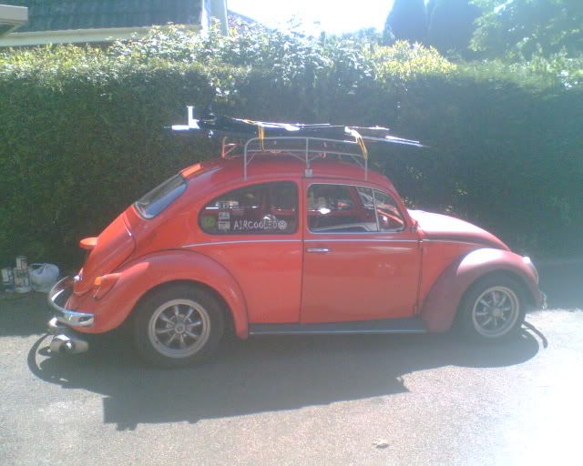

Nothing particularly interesting to report. Spent the last couple of days getting everything sorted before it gets its nose blown in on Tuesday. Finally it's all painted and wet and dried down and waiting to go
It only needs to go about 800 yards up the road to Dubmonkeys so I'm going to drive up like this, hopefully it'll be ok ;) Saves me getting it there and then having to disassemble it all again!
Also hopefully some good news on the high oil pressure situation. I took the pressure gauge off of one of the old spray guns I found in the workshop. Luckily the thread matched perfectly the thread where the oil pressure sender switch screws into the case. I screwed it in there and started up the motor, reved the car so the gauge in the car was reading 100psi at about 3000rpms. The gauge attached to the case was reading about 40psi. I'm hoping that all this time the gauge miht be out rather than the engine actually having super high pressure! :D
