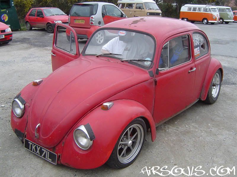

The front end on the Shitbox has had 3" cut out of it, mainly because of my silly offset US wheels :rolleyes:
(any excuse to post pics of my car :D :incheek: )
But i want more of an OG gasser feel and need to go narrower (possibly with flared front wings too ;) ) just wanted to have a look see :)

hmmmmm
thanks, wonder if the 4" ones are on spindles? what with their track widening properties

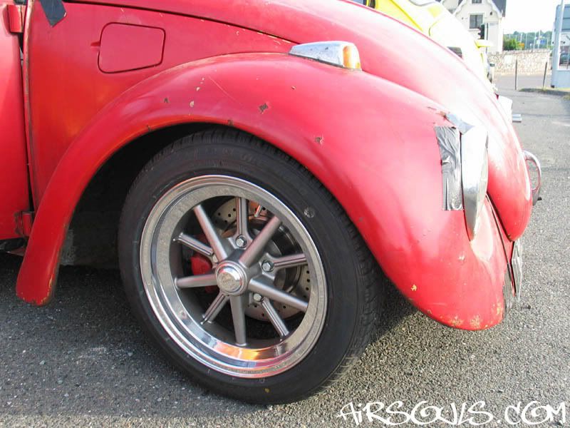

Did you have any inner wing issues? With my 3" chop we had to do some judicial 'adjusting' with some tin snips and a hammer :crazy:
Not that it's a huge issue, i'm contemplating a fuel tank re-location too ;)
Chopped inner wing, sliced & tweaked petrol tank box section, inner wing lip remade to join with petrol tank box section, all welded back together. Solid.

Hmmmmmm
think it'll definately be tank re-location time them, you can bet there'll be daaaaaaaaaaaaaaaaaaaaaaaaaaaaaaaaaaanger :D
913 Posts
no dont do any cutting im running a five inch beam with shock towers and no inner wing or fuel tank mods talk to merv hes done a
fantastic job on mine with his custom shock towers havent seen ANY as good as his ;) ps bill your cars hardcore love it!
3,986 Posts
Get a spun ali tank and hack the mother up you big girl :tick:
