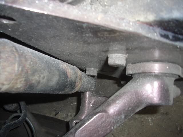

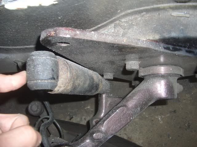

My van has a 4" narrowed beam, and I'm having problems fitting shocks to it before the MOT on friday. The shocks that came with the van seem too fat and foul on the beam mounting bolt. Any suggestions, I'm a bit miffed.
I might need narrower shocks perhaps? Any suggestions or pictures of what other people have done is much appreciated.

alright dude, long time no speak. to get shocks to work on a 4 incher you either have to chassis mount them in a laid back position to clear the beam bolts, OR remove the shock mounting stud from the lower trailing arms, clearence them (grind off about 3/4") and then re-drill and tap them for the stud to fit in deeper.

Damn, that's after getting the arms powdercoated :lol: - 3/4" seems a lot too.
I don't fancy the idea of mounting them to the chassis.
Cheers dude. I'm still playing with the idea of narrower shocks, but it looks like I could be forced to do what ya suggest.

yeah it is quite a lot, but that's what it'll take (an don't worry the arms are cast steel and not gonna fall in half if you do as i say) it would also help a bit if you cut the 'shit shields' off your shocks.

yeah cut the bottom shock bolt off flush-ish to the trailing arm, then re drill and tap a m10 stud in there, bolt the shock up to that you could even just take the head of that bolt a dab with the grinder too....
Mines slightly different as im useing T1 shocks.... but, as you can see ive had to cut a section of the mouting boss on the lower shocker mount, and seam welded the rest of it up so it wont be going anywhere, i also had to use half nuts!!!

All sorted now properly. :)
