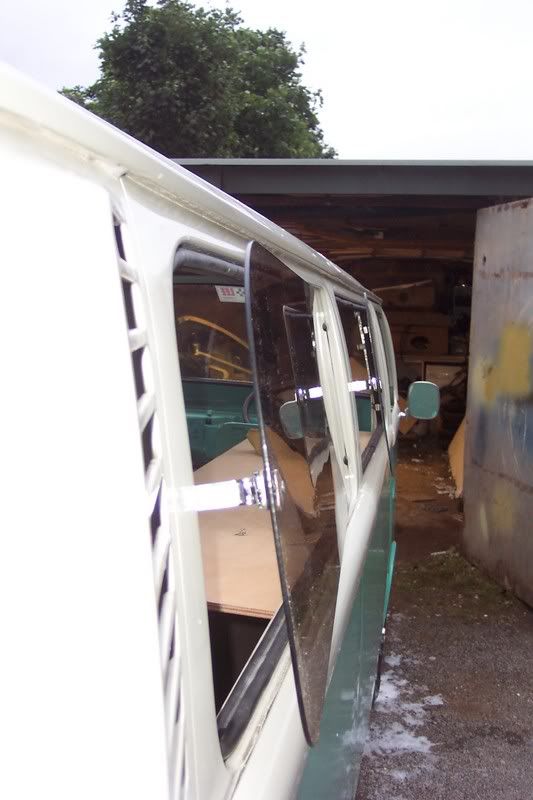

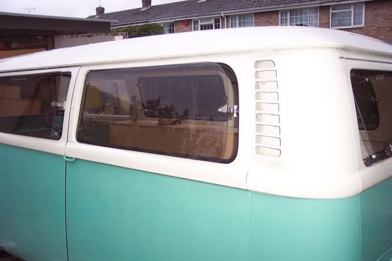

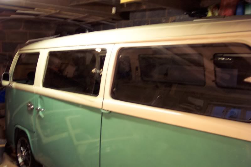

as you can see finnally got my pop out windows fitted and working just got to tidy up the extra holes i drilled . now i know how to i will scan pics of full resto on keep um peeled its had major surgery. just detailing underneath and about to start the long stroke motor build ready and rolling in may nxt year. :) :) wHAT DO YOU THINK NARROW THE BEAM OR NOT THINKING OF CARERRA CUPS 2 ?

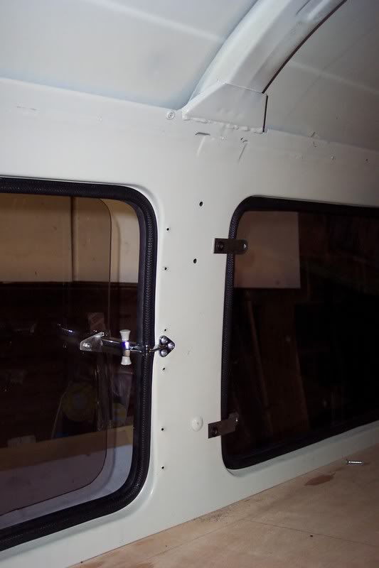

custom made glass. splitty catches which had to be taken apart and assembled differently fabricated bits and bobs mate.took an age to get them working properly

van was a total wreck to full rear corners complete rear side panel inner outer sills both arches list goes on. i will scan some b4 piccies when i have 5mins. i .may get some of the pop glass made up in sets to sell nxt year not sure on costs yet as the catches cost £160.00. lots of fabricating bits and bobs to get them to fit. glass was pricey to i think they would cost aroung £1000.00 with seals etc and fitting kits not to sure yet. will make a second sett up in winter to total cost. like i said there has been days of work just working out how to use splitty catches. nxt sett will be even better..

if u need any info on how just ask matey
