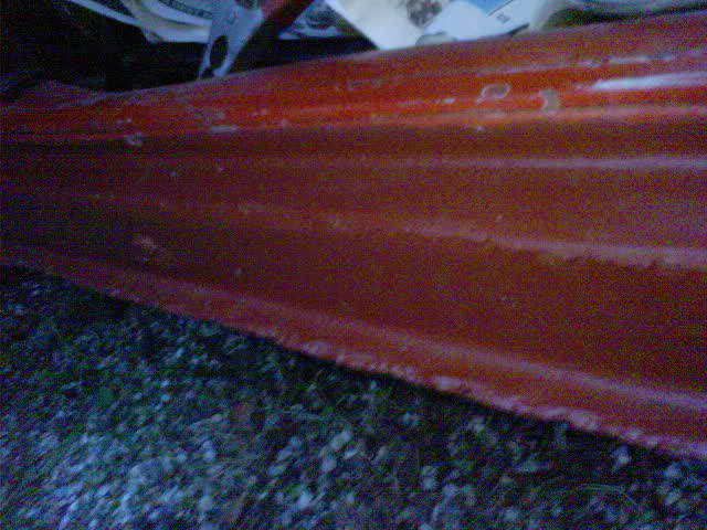

next job on the agenda was inspecting the heater channels so i removed and disposed of the old rotten running boards and set to work stripping the paint behind. this is what i found...
amazingly shiny fresh metal, it seems the forward area of the cills have been repaired quite a while back and have lasted. Even though the repairs are not to aesthetically pleasing doesn't matter to me as on this kind of budget the if it aint broke dont fix it mentality is very important :hangloose

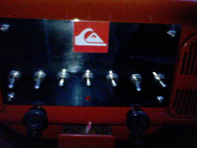

well, now on to the next job. My main concern was the electrical switchgear when i bought this car as most of the dash switches were missing! i've fixed this for now with a shiny race style switchboard which is clamped to the original radio opening. When i've found a 2nd hand set of indicator and wiper stalks i'll swap it back to stock though.

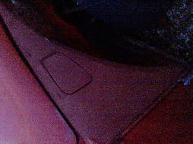

the next job on the list was to strip the rest of the interior. Behind the carpets i found.... suprisingly little rot! :coffeecup
the inner rear wings are looking nice and solid with only a few strong repairs around the bulkhead.
