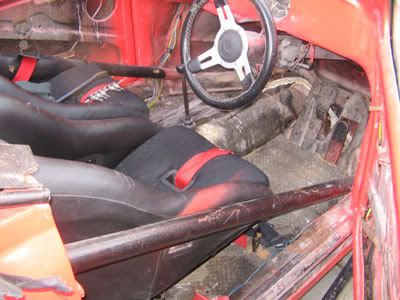

Just got a baja bug but the previous owner had lost the keys, so he got a Kro-bar and tore the steering column support off the dash so he could turn the wheels a little more (steering lock was on)! :eek:
Basically, whats the best way to get the steering lock to release - bearing in mind I have no keys????
Cheers! :hangloose

if you cant find a key to fit i'd drill the tumbler out ! its soft enough to drill out with a half decent cordless drill and a 12 mm bit , but so much easier with a key , the locks are usually well worn and just about anything will turn it ! :hangloose
