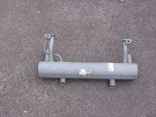

I have a standard 1200 engine.
will this exhaust fit?

That's a "Twin Hot Spot" exhaust, (there are 2 holes in the flanges just above the Exhaust to head flanges). It will not fit on a 1200 engine, it's too wide, and those "twin hot spot" flanges will not mate with the 1200 inlet manifold pre-hearer pipes.
It's meant for a 1300 (AR code) engine. Flog it on fleabay.
Don't know what the thing in the placcy bag is though.
FYI. "Twin Port", refers to the inlet manifold to Cylinder head connection, all 1200's are single port, as were early 1300' (F code), and 1500's (H code).
Later 1300 (mostly AB & AR code), and 1600, (AD code) engines are "Twin Port"

Is the twin hotspot exhaust a genuine VW one ? (Can't tell from the photo)
If it is, you could flog it, and it should return much more than the cost of a 1200 exhaust and fitting kit from GSF, check the prices.
the exhaust in the pic is not yet mine. thought id post it on here, before i bought it.
it is on ebay with 7hrs to go. at a tenner at the mo.....i believe it is a nos german one.

That's a pre-1963 34 bhp 1200 exhaust, note the lack of heater connection pods on the upper header tubes. This would make it more difficult to connect the air hoses from Fan housing to the heat exchangers on a 1972 1200 engine. Not impossible, though. ;)

you reckon i will have to cut the tinware? or is it just a cas of longer tubes..
either way i can visualise what you mean...in ref to the pods....

It's not a case of cutting tinware, but of adding something which should already be on the new Exhaust. The early engines had a completely different Heater system, not the Heat Exchangers like yours, and the early exhaust may not even mate-up with your Heat exchangers :eek: I can't be 100% sure from the photo, but that may even be for a 30 bhp engine (pre 1956), and I've never tried to fit one of those to a 72 1200. Too much hassel, :rolleyes: get the right one in the first place, 1200 exhaust from GSF is about £ 36. :D

I've had those danish ones, and I agree the quality is far better.
Was just concerned that it looks too much like the 30 bhp box to be a straight fit on a 72 1200, but now you have confirmed that it fits, that is no longer a worry.
There's still the small matter of the missing heater connection pods, it may be possible to transplant them off the old exhaust, providing the header pipes are the same shape, and buyer is prepared to do that. Alternatively, extended ally hoses from the fanhousing direct to Heat exchanger will work, but may compromise heater efficiency, (not that anyone would notice). :D
