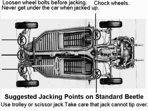

The jack as well, but don't use the jack for lifting;
the internal braces in the car body are often weakened
and will crush under load.
Get a small trolley jack and lift the car as shown here:
