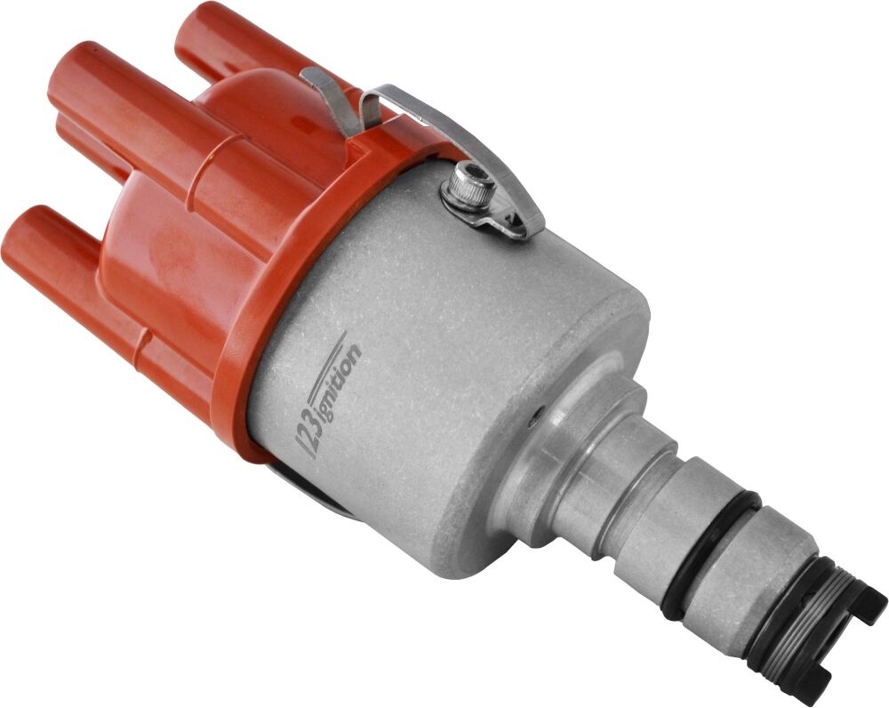

The 123 is a tasty bit of kit, but it’s still a svda so would need to set it up to get the advance curve to suit a 1200. The off the shelf svda needs the 34 pict carb to give the correct vac but that won’t fit on your manifold and is too big.

yeah, that's what I'm flipping the coin on at the moment, one vs. the other. The Bosch would probably be optimal for the 1200 for the year. But then, when I go over to a 1641 or 1776 (haven't decided that answer yet, and don't need to), I imagine the 123 would be a good choice. So, query (to myself as much as anything), is can the 1213 do a decent job for now on the 1200 then not be 'lost' money later... ponder, ponder

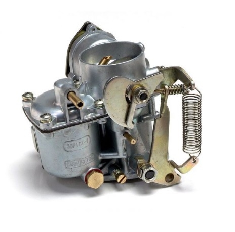

Agree on the carb. I've just emailed CSP in the last hour, to ask for some more insight. Possibly won't be able to shed a lot of light on that, so possibly considering sourcing something carb wise more definable from the outset (then just list that CSP one on eBay at 99p starting and take my changes at minimising the loss).
I'd go for a new Brosol 30/31 (or better) If I could find one in stock, but everywhere (the usual web sites) are listing out of stock in the UK. Few around in the US.
Cool Air do have this
or there's these on eBay at the moment
I like the fact the last one's actually Solex/VW. Maybe I'm a bit paranoid, I'm just worried I don't know what I'm getting secondhand, but then new's not doing me too many favours at the moment.
As you say, If I've certainty on the carb then I can get certainty on the direction for the dizzy.

My stock carb is a 30 pict 3. The worse wear point on a stock carb is the throttle spindle. You can get them machined and rebushed though if needed. The only other issue is if the carb has sat for years and corroded up inside one of the passages, which is a pain to sort. In theory any 30 pict carb should have the correct vacuum signal for the stock distributor, but a genuine one would be best.
#25 ·
Guy's, thank you very much. I'll most probably go for the eBay 30 pict3, given all these insights. Then sort the Dizzy, whether SVSA or SVDA. If the latter, probably a 113-905-205T, as

So, if I go for this carb
VW CLASSIC BEETLE + T2 BUS VAN SOLEX 30 PICT 3 CARB CARBURETTOR 1300,1500,1600cc | eBay
(seems to be right, and has the pinhole type vacuum)

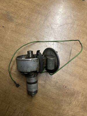

#29 ·
Well, my Pre- June 1974, (No. D01256---), has the original Vac only distributor 111 905 205 AA, (Bosch JUR 4 0 231137 039), and it works well with the original SOLEX 30 PICT 3 carb with the pinhole bore vac connection.
In my 1969 version of the VW dealer workshop manual, the 111 905 205 T is listed as an acceptable Replacement for many other versions of the stock Vac only distributor on 1200 - 1500 engines.
Hope that helps.
