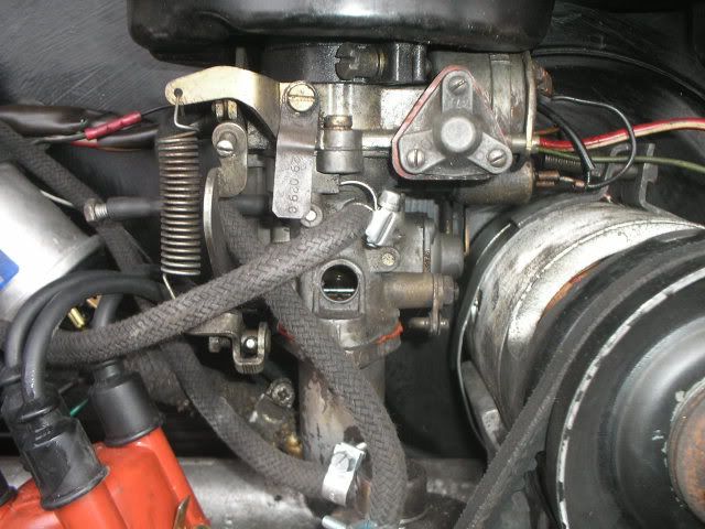

Went to start the bug the other day and found it was backfiring and running very badly. Had a look at the engine to find this hole in the carb . I have got another carb to go on but was wondering is there a reason why this has happened.

I think it is a plug that is fitted once the carb has been made. I had a bug that that blew on I was in the middle of nowhere so glued a penny over the hole with araldite (spelling?) was fine for years

Hi Mate you have blown off the blanking plate, Stick a 5 pence peice over it with some blu tac and it will be fine, Mine has run for 3 years like this now with no probs.
maybe an idea to investigate why you backfired in the 1st place, check your timing etc

It was running fine be for this happened.
