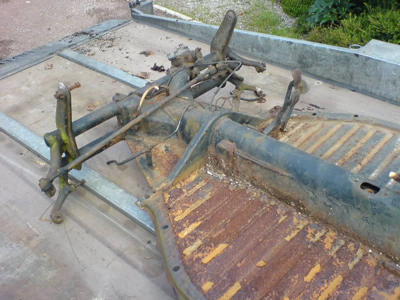

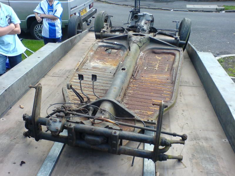

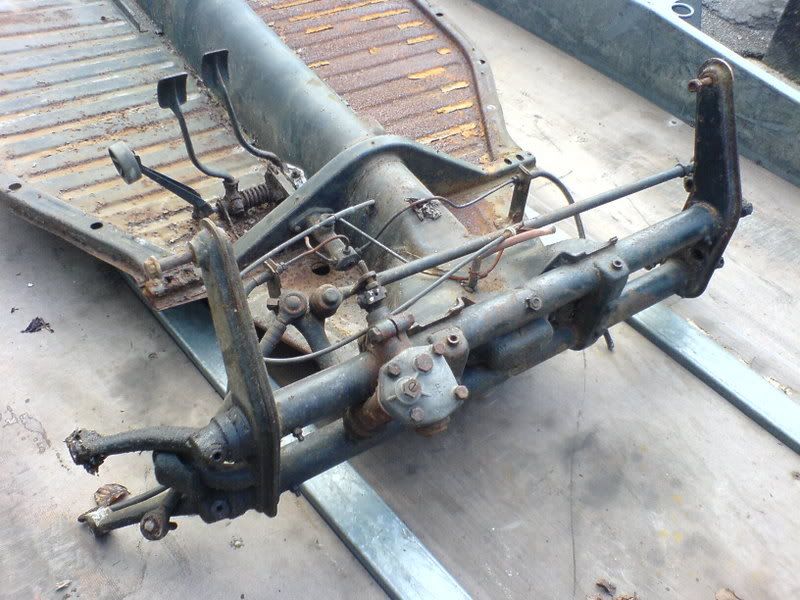

Non renewable track rod ends. Master cylinder?
No handbrake adjusters.
Sraight rear suspension 'towers'
It came from a 59 cab but looks to be an earlier floorpan. Need to know the latest possible year it could be please :) Oh and will need valid reason, not just stabs in the dark. ha ha :)
Thanks all in advance, Al :)
2,429 Posts
It's no earlier than Oct 52, due to the rear suspension and no later than July 55, due to the heater control position (I believe). I am sure there are other indicators that might narrow it down a bit more.
21,411 Posts
Moby5153 said:
Pre-Aug 55, but it's too late to do any further checking, I'm going to bed. No chassis number?
I think the cab was crashed in the late 50's/60's and has been rebuilt using a different floorpan and new front clip.
The body that came off certainly is post 58 as there is no speaker grill in the centre of the dash like an oval.
I think that after the rebuild a new plate was put over the existing stamped numbers on the floorpan (hence the 2 holes). The car was also re-registered as B reg I assume afer the rebuild and some fool plated over the semaphore holes etc making it look like a later cab.
in short, no chassis number, sorry.
