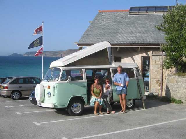

Daisy meet Daisy
introducing Daisy to Daisy

GJB
Daisyjayne
What a beautiful van,was that a restoration or did you cheat a bit & buy a ready runner?Where is that pic taken that scenery & coast line look somewhere worth a trip when my Daisy is done. :D
Did buy a runner but did a lot of work to get her looking like that.
the photo was taken in Sennen Cove which is approx 2 miles from lands end and our heaven on earth, bin down in daisy twice this year which is 730 mile round trip for us but worth every inch you ought to take your daisy down when shes up and running Cornwall is fantastic in a camper.
