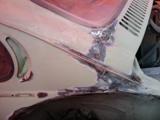

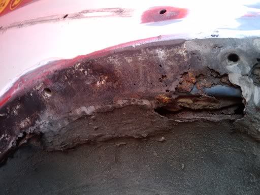

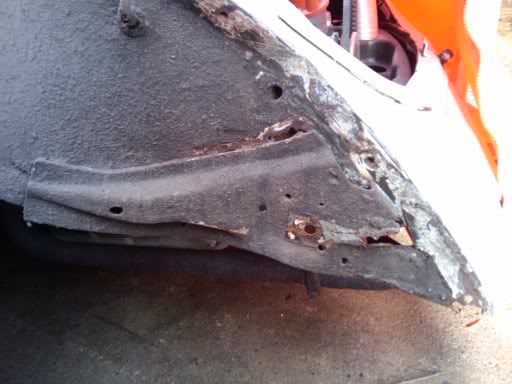

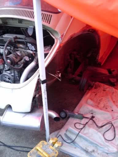

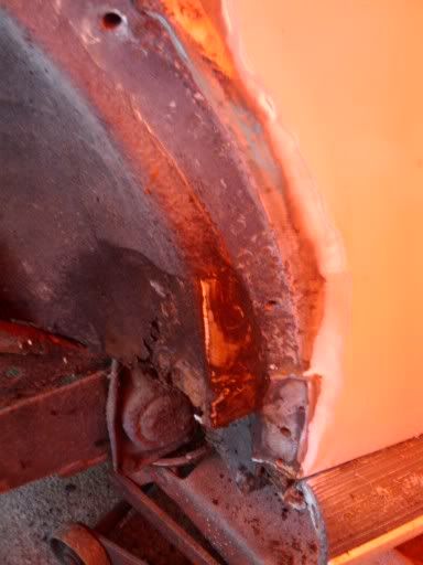

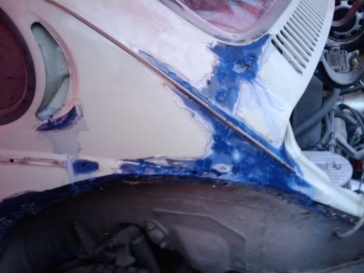

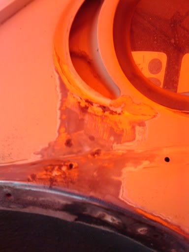

Wings off to review the rust situation :eek:
Actually not as bad as it could've been, so quite happy really.
All rust areas available as repair panels which is good news.
Mind you some will have to be made....
Got to work with the soft pad grinder and rust treatment to this stage:
Remember I only want this to be a low time/cost repaired car so will be patching where necessary.

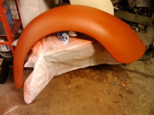

18-12-10 update
Wings off (well 3), flooding under the gazebo made it difficult to get the last front wing off. Yesterday, it was cold and snowy so decided to prep the 3 wings that are already off.
600grit wet sand got them flatted nicely with a little help from the airsander on some small rust spots along the inside edges. More like rust creep, just under the paint which was soon sorted with rust killer and a nice coat of red primer from a rattle can. This is not to be confused with 'red oxide', I think this stuff is primer coloured red!
I'm pleased with the way they have/will come out, considering they are pattern parts (sorry lightened metal race wings :incheek:).
The plan is to replace the beading with satin black (instead of gloss), refit the stoneguards and '66 rear lights with smoked lenses and bluedots and LED bulbs. I'm interested in the look of the lenses with an LED behind the bluedot, could look v/good me thinks!

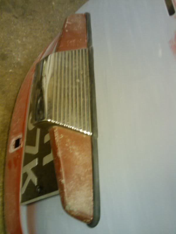

Decklid detail
I wanted to change the decklid to a twin vent version, when I found one at Parts Emporium I also spotted a VW number plate light shroud which I could make fit with a bit of fettling:
Can you tell what it is yet?

Decklid detail
Went from this:
to this:
Guess what the number plate light housing is from?
Liking the chrome detail & lower position which makes the number plate look a lot meaner (or snug). Also, the twin vent rather than the 4x vent look. Will probably leave it badgeless to make room for the pin striping, so it will look clean and uncluttered.

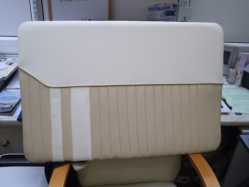

This old bug was first rebuilt and modded in the mid '90s, in true '90s style with standoffs, pale paint, XR3 interior etc. Nice as that all was, I wanted an updated/retro (makes sense?) look with a bit of hot-rod in there!
So had the interior trimmed in a 'tuck n roll' style.
From this:
to this:
and this:
I kept the bottoms of the XR3 seats cos they're comfy but removed the headrests to give them a retro low back look. Makes them hard to recognise as XR seats now. The colour combination will compliment the new body colour v/nicely I think.
number plate light is from a fastback.
FYI you can't use 911 lenses with a US spec headlight behind them, the pattern will be ruined and the light output will be too heavlily disperesed - you'll actually lose visability.
911 lights in a euro light is no problem and improves the output/pattern.
Ah, thanks for the advice :(, I think the headlamp/bulb holder has been changed/upgraded but will check it out, cheers
You're right, the number plate shroud is from a notch/fastie. Took a bit of dollying to make the convex lid take a crease to allow the shroud to fit flush. Just a little cut n slice here and there, then formed the crease using a heavy angle iron bolted through to a heavy bit of bar and I got the crease I needed. Welded the holes, bit of filler and it's good to go!

Thanx Pooley, Glad you get what I'm doing, I'd rather have a runner to enjoy, fix it n fun, than a loooong term garage project that takes years to complete. The you end up with a car you're too afraid to use 'cos it's immaculate, been there had that, nowadays I want a 'slam door' driver I can use man.
Thanx for the kind words on the trim, wish I could take the credit for the upholstery job , but the re-trim was done by a friend of mine Noel Deegan, runs his own biz, Trim & Fit in Slough area.He's not too dear and does a v/nice job. He's got better at it over the years I've known him do it. Catch him on 07779054178 and here:
http://www.fordconsul.co.uk/index.p...stery&catid=74:upholstery-services&Itemid=103
Mind you, the colour scheme and style was all my idea (smug :incheek:) Those seats are heated as well, hence I have a 36hp fan housing and alternator to bolt on soon.

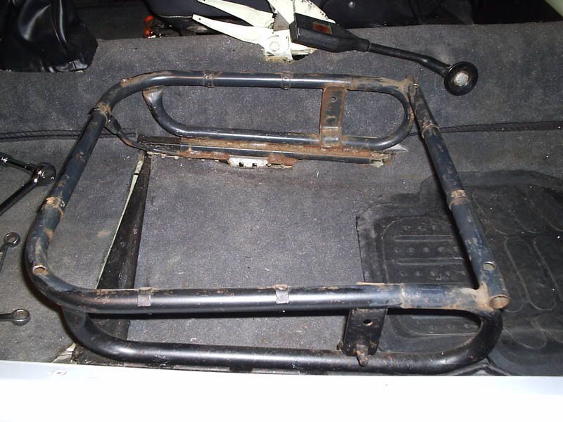

XR seat onto bug runner mod
Here's how the bug runners worked for the XR seats, probably too old now to be useful, but the general idea could still be OK I guess?
Runner/frame in place without seat:
You can see the holes drilled through the frame.
Simple nut & bolt job:
Picking up on a corresponding hole in the seat frame. Allows you to do this:
...and then this:
Hope this is useful to someone?
