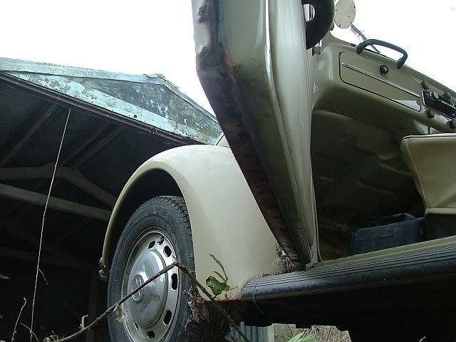

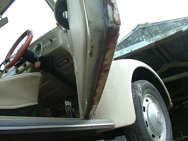

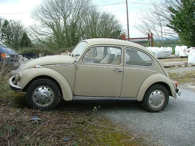

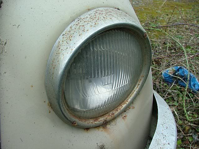

After a long time looking we finally purchased ourselfs a Beetle. I got this 1968 Semi Auto off here and I went down to Devon last week and drove her back to London. I was praying she would make the journey and the car had done hardly any miles in the previous two years.
Here are some photos the seller sent me before I went down there, I had to buy off spec and photos and the journey was too much to do more than once.

It looked a bit rough and it needed a good clean but there didn't seem to be any major issues so I decided to go for it and head down and buy it.
Simon seemed an honest bloke and the car has 12 months MOT so it would at least be a rolling project car.

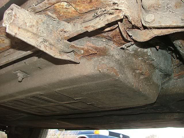

I took the running boards off and I wish I hadn't:
Passenger side:
Big hole:
Drivers side:
Big hole
So what is my best option to sort these holes? I want to do as much as possible and I am looking to get a welder. So are these rust areas an easy fix?

So can I get away with cleaning the rust and sorting it filler? Or should I cut the back out and replace them?
9,503 Posts
Looks like a great project!
Agreed get rid of those foot pedals and replace the wheel with a nice D -ring?
Refering to the pic from last of the right gutter, you need to cut and replace as it has already rotted ;) as far as I can see.

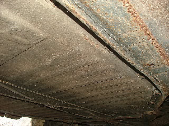

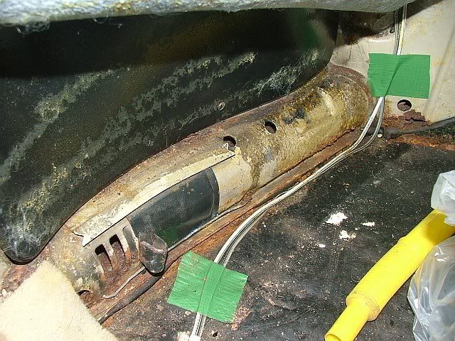

I only got an hour or so to work on the car tonight but in that hour I made some pretty depressing discoveries.
I first got the passenger seat out which was a pain in the balls as it was jammed but some gentle persuasion with my unjamming tool got it out. I then removed the tar like crap that was on the floor (which I can only presume was some sort of primative soundproofing) and this is what I got:
It's all surface rusted where water got under the tar.
I then pulled off the bits of carpet that was on the sides and it got worse from there:
I then noticed this load of silicone:
which revealed:
a previous owner had cleaned up the drivers side and put rust bullet down so there was no carpet or tar on that side but there was carpet and a panel for the speaker when I removed them I found:
So I am pretty pissed off now. It was bad enough when I found the holes in the channels but now I am out of my league. I don't even know where to start with these holes.

Sorry to say but it looks like you need a new pair of heater chanels and other associated repairs.
Depending on your budget and the length of time you intend to keep the car I would go for Genuine parts and not the cheap stuff which is a PITA to fit and often doesn't last -GSF seals have leaked from the first time they were installed, engine mounts failed in months...
Status VW have been the most consistant with quality over the years and provided me with the best part for my last resto, I'm using them again on the current project.
My advice, get the mechanics and body sorted then move to the paint, interior and chrome..
Good luck, Semi Auto's are lovely cars to drive. :)

Agree with this, although to be honest its pretty good for its age as those heater channels are original. You can can fit repro heater channels although I prefer genuine ones as they are so much better quality, but you can only get the late ones. The hole where the silicon is, is probably due to the drain tube for the air box or the air box itself not being present, so water is getting in via the grill in the bonnet. Replace this and a small repair to the hole and it will be sorted. Good luck with the resto, semi autos are cool.
