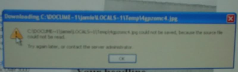

i think my computer is poorly i left it on during a thunder storm and the power went off a few times ,
since then i have been having probs with it,
if i try and save something, ie a picture or file i get a pop up saying "........ because the source file could not be read"
anyone got any idea what im on about ?

post the exact error message, or a screenshot of it.
Is this only when you try to save? or also when reading some files?

heres a dodgy pic i just took of the message !
i have tried resetting the computer to a date previous to the "lightning incident" !,
and have done the dell maintenance check but no change
it doesnt always do it when i save (i just saved pyros sherlock picture for example!)
but appears mostly when i try and open a file (ie the pics of a mk1 that im thinking of getting :mad: )
whats a scandisk (get the impression i should know, but i dont!)
Ok - looks like a temp file and therefore nothing to worry about...

done the above ,but,it is still the same !!
i cant remove some of the temp files "because they are being used" (how do i get rid of these ones ?)
and i cant download any new anti virus / spyware because i cant download!
