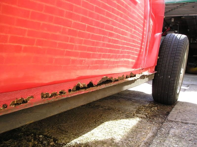

Taken the Wizard off the road for the winter, and have found a bit of welding to do :( Still, I could do with the practice :rolleyes:
I've got a smooth dash to fit, as some chimp has cut the original one, with something as sharp as a lump hammer :eek:
A new hood is also in the loft, ready to fit, but I'll sort the rot out first, and then think about what colour to go with, as I am bored of the red.

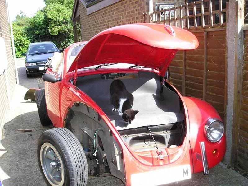

It's actually a guard cat, as I can't afford a Thatcham approved alarm ;)
I have started the welding, but as I'm learning I'm going to let someone else tackle the Bottom of the door post. :)
Oh, by the way, thats seam sealer over the welded metal, not filler!!

if i were you matey, id be stickin some primer down before alluping seam selant to bare metal.. just my 2p!
224 Posts
Cheers Alex, like I said, still learning :)
I have decided to go with satin black, with a red interior, but I've got to clear some room in the garage, as welding outside is using up a load of gas, and the weather is beating me at the mo :(
