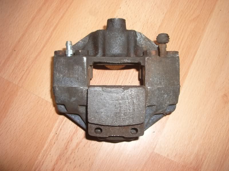

Hey guys,
Just wondering which pads to order for a set of varga calipers i've picked up for my bug. The ones that came out of the calipers look different to all the VW ones, as the top - where the pins pass through - aren't indented on mine, whereas the VW ones are (may make no difference)?
Also, the ones that were fitted into the calipers were extremely tight. I had to hammer them out. I've cleaned up the inside of the calipers, and the side of the pads, but they still seem pretty tight.
The back of the pads are corroded, but im sure i can make out Varga on the pads...

normal 2 pin beetle pads fit, they do seem to vary on the tightness factor and sometimes need relieving. dont loose the 'r' clips, as they dont come in new pad sets, altho' you can buy them, or use proper lock wire.
Ace, cheers. My current ones are exactly 56mm - guess i may just need to shave a bit of the sides! Thanks for the part number Moby.
Polish the insides of the calipers and copperslip them.
Note the price of the above. ;) Depends if you're in a rush for them or not though.
Gotcha :) I'm not in a rush, and can't get them for that cheap! What is that price from? Cheers, Patrick
From my NOS collection. Mail me if you want some. I think there are two sets of that type, and a few sets of single pin.
Moby - new pads i got from you are perfect. Slipped right in, and are braking well! Cheers for your help :)
