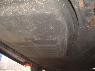

Hi peeps any suggestions as to what to put on the underside of our bug to protect/seal it...........thanks :) this is what its like now

underseal it! its good sh*t, stops anything from getting to it even daylight! just put it on thin layers at a time, if you put think blobs on it takes eons to dry!

aparently the stuff to use is por15 havent used it myself but everybodies raving about the it.
yeah i reckon i'll go with por15,once the heater channel issue is sorted :)
I always paint my floor pans with a couple of coats of red primer, then a couple of coats of hammerite.
i use red oxide primer too!
but what i have done in the past is, prime with red oxide primer, then underseal, stops the rust growing under the underseal then. although lately i have taken to using red oxide and then a coat of exterior gloss as when you need to do repairs in the furture it makes life easier.
