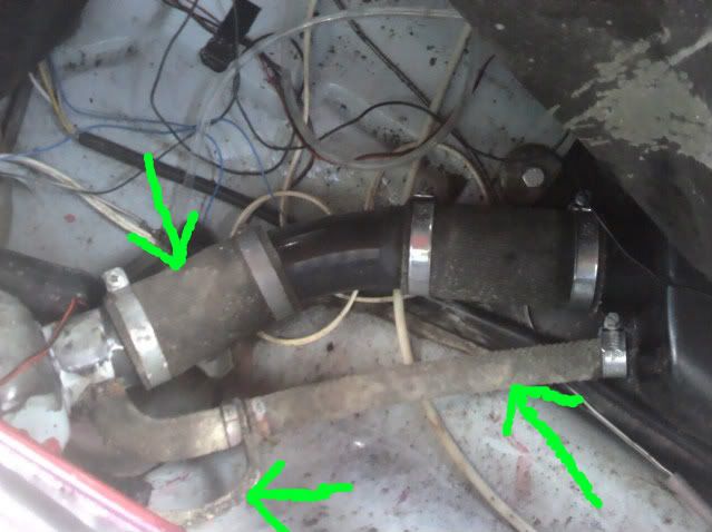

Can someone please let me know the size of the small and medium fuel breather hoses on the filler assembly and point me towards a supplier of quality hose (bottom two green arrows in the photo)?
#3 ·
IIRC, the small one is 3mm ID. For the fatter breather hoses, try this and this from VW Heritage. Check them first though - the photo of the first one looks like the 90Âş elbow but the title says 45Âş and neither lists the ID.
Failing that, I bought this kit from Mid-America years ago when they were the only supplier in the world I could find who stocked the hoses in any format and it did the trick.

i'm having the exactly the same issue, smells of petrol when i go round a sharp laft hand corner.... and i dont fill it more then half full cos of this.
that very small hose is probably the same as spill off hose, i'll take mine off tomorrow and have a look, will stop in at a local car shop and see if they stock it.
is coolant hoses rated for use with fuel?

hmm I did see those but wasn't sure re: the description as you say
Cross referencing the Heritage part number of the "45 degree" pipe with Status and it actually comes up with this:-
133 201 179 Vent hose on the fuel filler neck. For 1302 and 1303 models only 71-79.
I think I might need this instead:-
Breather Hose Pipe: 311 201 179 A Connecting pipe bend for the breather hose pipe.
http://www.status-vw.co.uk/shop/contents/en-uk/d351.html
I'll bung them an email.

There's thin rubber sealing rings between the main 'fat' hoses and the metal pipe sections from the filler at the top of your photo. If these have perished then you might be getting fuel smells from there as well.

all fixed :)
you dont need the 90 degree piece, straight bit will bend fine.
crappy old pipe
new bits and new clips... much happier! oh the really small pipe is just diesel spill off pipe, very cheap :) (hadn't fitted it yet in picture)
