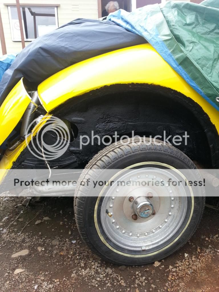

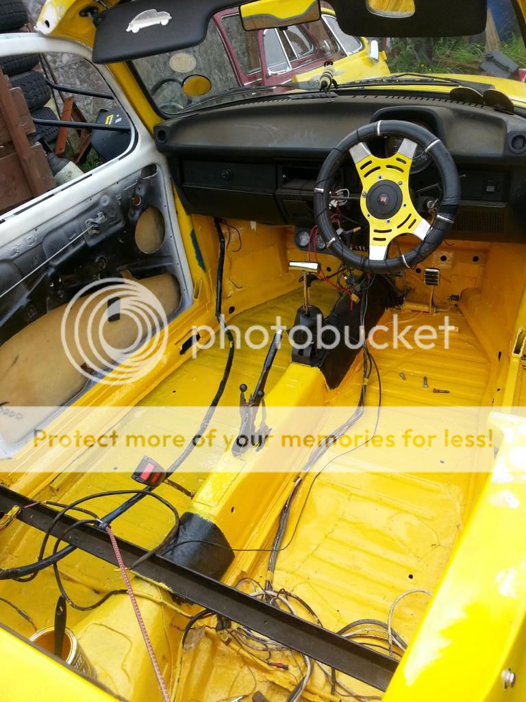

#21 ·
this was it before i stripped it, the heater channels was in a sorry state
this is where im at now (heater channels replaced, floor welded and a few coats of yellow on the floorpan)
little bit of welding to do including fitting a new front valance, respray and im good to go :)
