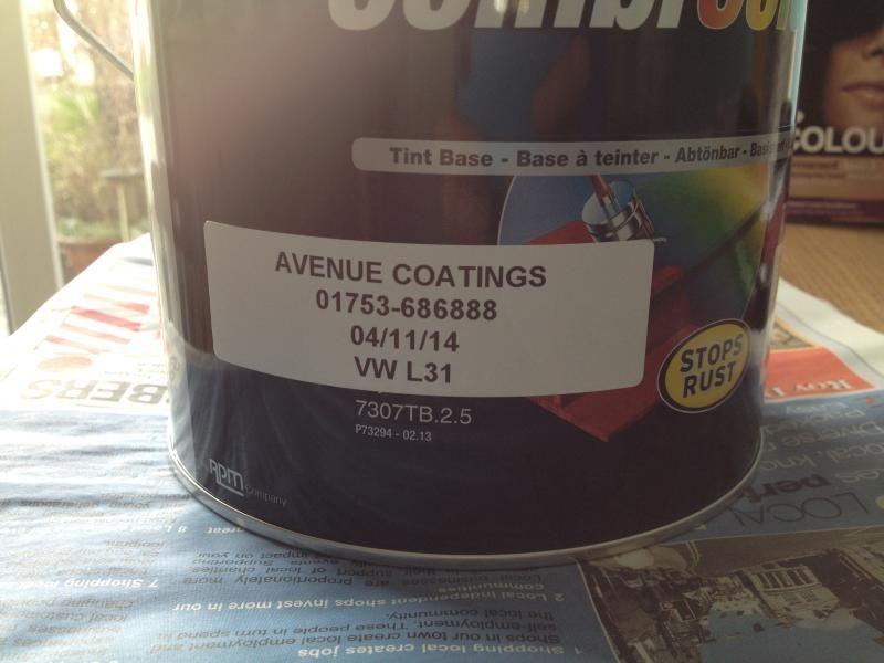

Hi,
Got my Dove blue rusto coming, and i'm thinking roller, but seen a couple electric HPLV guns about and heard some good results...
same for rollers though!

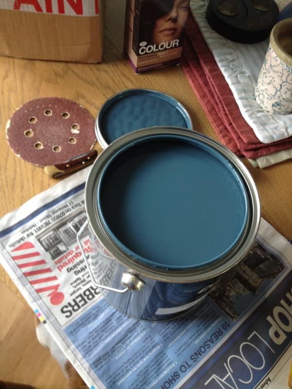

got some 180 grit disks for my orb sander to give it a key on the old paint and some 600 for between coats (wet) :) excited!
Spent under ÂŁ42 on mixed paint which came out great, i asked for dove blue.
and ÂŁ38 for a brush, two roller packs and 10 spare rollers, two 5 packs of orb paper, masking tape and some micro towels for wiping down....
ÂŁ80 paint job coming up....
