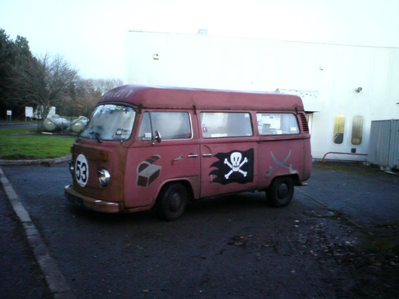

right how he looked last october
after a day with a 9" cutter
after another weekend cutting
the idea was to use the original chassis and floor the way the yurgens are built but when the belly pans were cut away all i found was
so after alot of head scratching decided to build a new one
oh before you all ask i am a coach builder by trade and the chassis will carry 1.5 tonnes in the centre without any movement or twist
now was time to start building the body jan this year was looking like this
decided on a shape with help from maddog and percy P
#7 · (Edited)
a little bit of work on the rear chassis to get it down on the deck :D
all the way up
all the way down
all my mates helping out we got a lot done that day
me and bechham fitted the roof the following day
then spent a few evenings making a fuel tank
#13 ·
missed a lot of photos out but was so busy just kept forgetting
but had to edge all around with ally trim fix the floor down.
then the cab needed sorting so new door skins, new arches and new front lower panel then frantickly try to build the beds and get some sort of paint on it but was down to the wire like all these projects
so ended up with just priming the cab oh and the all important eye patch and his name put back on :D
heres how he looks now have started building the furniture for inside got all my apliances ready and all the wood so its just a matter of building the units then i will post pics of him inside and out
taa daaa
not to everyones taste im sure but I LOVE IT :D:D
